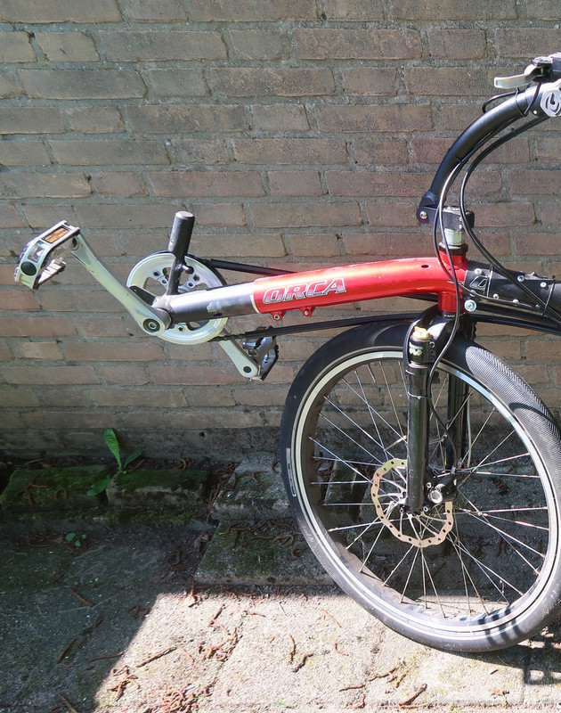

Hi Giacomo,
Looking for something like this? It is for 1 1/8 inch threadless fork, came from an Optima Orca recumbent (26" front wheel).
[Afbeelding: IMG-MIX2S-20251227-223722.jpg]
[Afbeelding: IMG-MIX2S-20251227-224911.jpg]
[Afbeelding: orca.jpg]

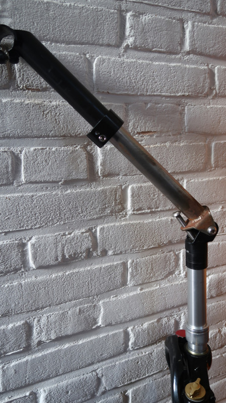

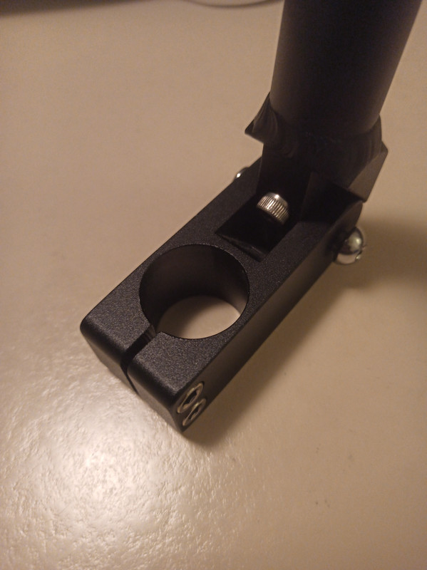

Here is another stem:
[Afbeelding: IMG-2363.jpg]
The black part fits around a 1 1/8 inch threadless fork but maybe there is missing some clam thing around it?
The steerer tube is a bit rusty though and the bolts are so tight I cannot remove it from the stem.
(28-Dec-2025, 12:53 PM)De tovenaar schreef: Here is another stem:
Yes, both of them are exactly what im looking for.
If i find someone thats flying to Nairobi (Kenya) or Riyadh (Saudi Arabia) from Netherlands in the next 2/3 weeks and is willing to carry a stem, it would be a possibility..
(28-Dec-2025, 09:20 PM)jackventure schreef: Yes, both of them are exactly what im looking for.
Ok, I will hear it later and you can contact me on Instagram. I guess the black one is the better one.
